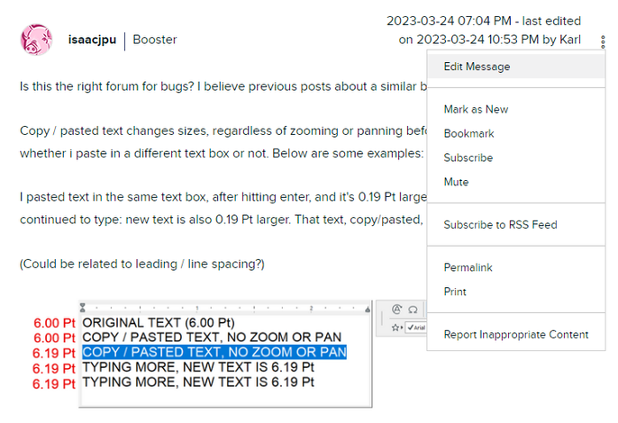

Copy / pasted text changes sizes, regardless of zooming or panning before pasting. This also happens whether i paste in a different text box or not. Below are some examples:
I pasted text in the same text box, after hitting enter, and it's 0.19 Pt larger. After pasting, i hit enter and continued to type: new text is also 0.19 Pt larger. That text, copy/pasted, (line 5) remained at 6.19 Pt.
(Could be related to leading / line spacing?)
Tried again; this time at a different original size. (7.00 Pt) This time the text was pasted 0.08 Pt smaller. After hitting enter, new text on the next line was back to 7.00 Pt. The fourth line of text copy / pasted (line 5) was 0.08 Pt smaller again.
