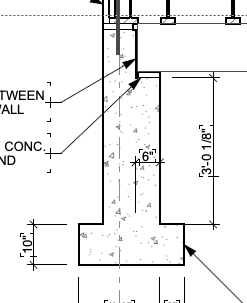

i think i have the same question? but not sure if similar. can't figure out why my bump out concrete line work (6") does not show hatch or pen style as the concrete seen on the left 6" call out.

If a part of the geometry is not cut, then it will not have a cut fill and it will be show with the View Pen.

i thought it was related to my location of section cut as shown below but it doesn't matter where i drag the cut line i still get nothing. will look at the settings for view pen as you suggested Laszio, thank you.

Out of the two vertical lines of the Section on your screen, the one on the left is the Section cut line (where the numbers are). The other one is the line specifying the depth of how far the Section would generate the model.
Zdenko
Laszio! thank you!!!! that solved it! i learned something today
