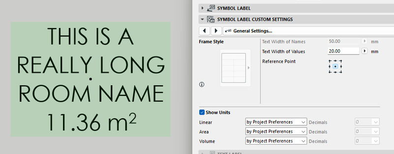

What settings do you have under Text Style?
It looks to me like you are using a zone stamp and Ling has shown you a zone label.
There may not be a 'width' value in a zone stamp but there may be a 'number of characters per line' value in the parameters.
But that may depend on the stamp you are using, they all have different settings.
Lingwisyer
Guru
That would explain the missing text settings.
You can force the width of the stamp in the same way. By default the option is unchecked and the width matches that of your zone name.
