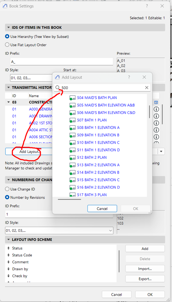

If you have 100 revisions you can just simply filter out and add layout within book settings
then you just select the first layout then press hold shift to the end layout you want to add.

If you click the arrow next to "add transmittal set" in "edit scheme" you can add a manual issue date (and anything else you want the transmittal set to have.
