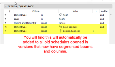

Have a look at your schedule criteria.
You either have to specifically tell it to include a 'column' and 'beam', or tell it to exclude 'column segment' and beam segment' if you want ALL elements.
You will find that if you open a file that had a schedule created before segmented beams and columns were introduced, in a version of Archicad that now has segmented beams and columns, there will automatically be an addition to the schedule criteria (even if the schedule has noting to do with beams and columns).

Even Element schedules can have beam/column and beam/column segments - my image was from an element schedule.
So it should just be a case of being specific about what you want to schedule in the criteria, no matte what type of schedule it is.
