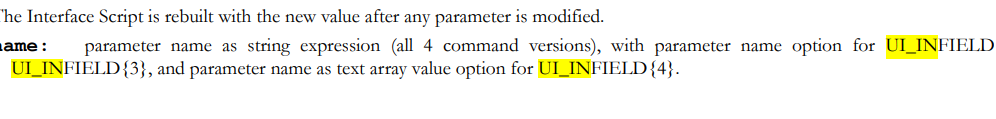

I would like to use arrays for certain fields; is there a way to have the UI allow a drop down from an array field rather than what Im getting atm
Manual states
I need a drop down for each array item and dont want this behaviour which jump s the user to an standard array input and not highlighting the relative index
I would like each field to display the field value
