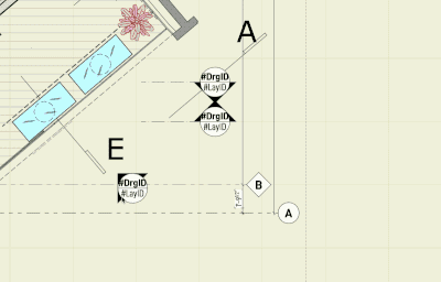

I recorded a short video showing the issue. In the first attempt at drawing the line, I press R for reference distance and I’m able to enter the 20' distance I want without any problem.
In the second attempt, I try to simply type 20' directly without pressing R or any other key. You can see that after I type the 2, Archicad automatically inserts the feet symbol (') before I finish typing the number. I then have to delete that symbol in order to type the 0 and complete the distance.
In the last attempt, you can see what usually happens when I’m working quickly. I’m typing distances fast and don’t notice that the ' symbol was inserted automatically, so the value becomes incorrect and I have to stop and go back to fix it.
Previously I was able to work quickly and type distances directly without Archicad automatically inserting the feet symbol after the first digit. Now it happens every time unless I use R for reference distance, which slows down the workflow.
