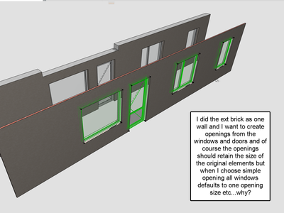

Change all windows to simple openings...and keep the size.

Better use composite wall, unless the brick is separated for the renovation purposes.
The openings are best to be converted to empty one by one. Or, JUST select them and change to empty. Any parameter transfer will transfer the size, unless you switch it off...

The brick is separated for scheduling (5D-project). I can't convert them one by one...I tried selecting them and change directly in the infor box but no matter how I do it the openings all get the same size. Maybe I need to open object settings and inject with a transfer option. Will try later.

First, select all windows and then choose this option
Then select all doors and then do the same for them as well.
Archicad will create an empty opening the same size as the door/window.
It will not work if you select doors AND windows at the same time.

Nope https://youtu.be/eCjayp0EMuU
I have a faint memory this worked for me like ten years ago ...or so...

How to  maintain the original windows size, when using this "use an empty opening"? All the selected windows were replaced with the same size opening.

If you add Emptyopening to your favorites and uncheck the window size in the element transfer settings, the size will not change.

You can select all windows/doors & "Create openings". Maybe you change reveal in this time for intersection to brick wall.

So that is the trick!
Create a favourite for an empty opening.
Create a transfer setting that does not include window size.
Select all of the windows you want as empty opening, right click on the 'Empty Opening' favourite and choose 'Apply transfer setting',  and use the 'No size' transfer setting.
As Mats said, I am pretty sure you could just select all windows and change to empty openings before, but that must have been in the days before we had element transfer settings.
