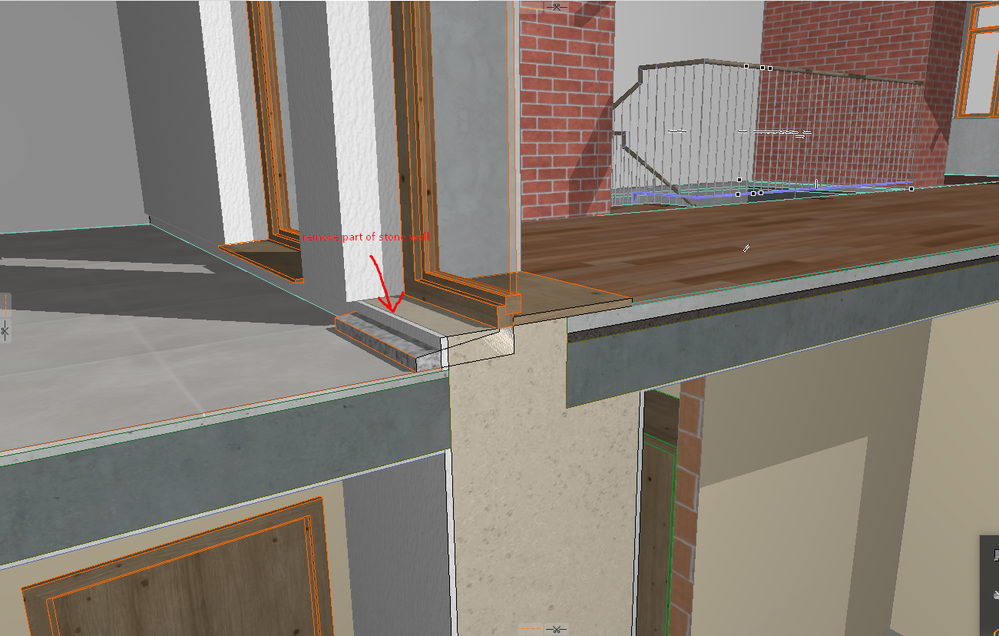

I have a door with a threshold in a renovation. The threshold is occupying part of the stone wall that comes from the previous floor and i cant seem to remove that chunk of wall, so it doesn't clash with the threshold. I tried SOE, but considering the wall is from the level below and the threshold is an element of a door from the wall on the storey above, it does not recognize any operation.
What can i do?

a workaround would be to put in a slab/Morph in that same footprint.
Use that to create the SEO with the wall below, Then put it on a HIDE layer.
downfall is that if anything moves or adjusts, you have to remember to move that element as well.

Yeah, i thought about that, but then having to manage invisible layers for SEO's like those can become a real pain in the ass, tracking all those hidden objects you had to use for these operations. I see sometimes AC has some really cheesy workarounds, i was thinking there was a legit way to do it.
