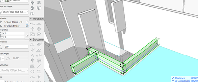

I would like to know how to make only the home story change.
LeeJaeYoung
If you change the home story on the wall, the top link also changes.
So we need to change the Top link again.
Should I increase this feature of the Fat Palette alone?
AC27 on window 11
1 ACCEPTED SOLUTION
Solution
Patrick M
relink home story will pull top linking if it conflicts with the initial geometry. Changing home story in the wall settings will not; it will mess with the wall geometry and position. Maybe this helps explain it a bit better?:
(uploaded vid may not be complete at the time of posting this)
https://youtu.be/tlfST8szx3g

Patrick M
right click > relink home story. position and geometry should remain as-is, but home story association is updated.

My question is how to keep TOP LINK from changing even if I change HOME STORY.
AC27 on window 11
Solution
Patrick M
That is the whole idea of the top/bottom link.
When you change a storey height, the walls will follow.
If you don't want the walls to change, don't link the top/bottom to the storey.
