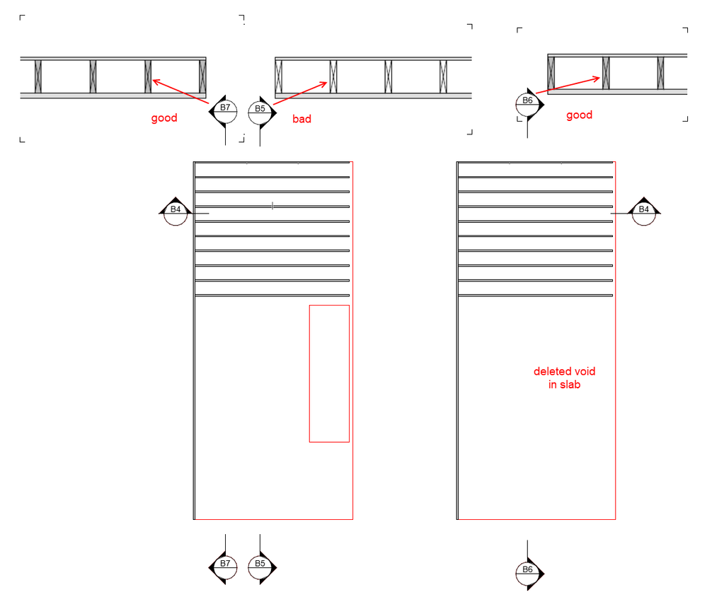

Hello
I have a joist object (written a long time ago (v19) and when in the same model space as a composite floor, the object fill doesnt show. However, the strange thing is that the object fill shows correctly in other sections. i have checked, layer order, done a solid operation, changed intersection priority but am stumped. Can anyone help please?

Attached is a .pla file. Hopefully youll be able to see in section A that the the joist is shown correctly (i.e. with the dark fill). Yet in section B, the darker fill is not visible.
Thanks for looking into this.
Solution
Thanks for the PLA.
I know what is causing the problem (I think), but not why.
When I copy one slab and joists, I see the same problem.
The void in the slab seems to be causing the issue, I don't know why.
Cut a section looking away from the void and it is good.
Delete the void and it is good.
Obviously these are not solutions though.
But I found if you turn on transparency in the section settings, it look better.
But of course transparent materials will be see through, which may or may not be an issue.
