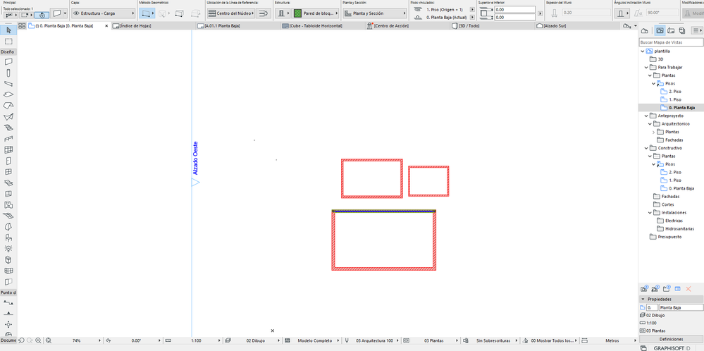

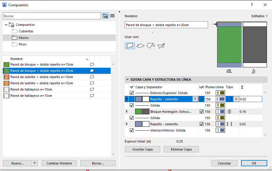

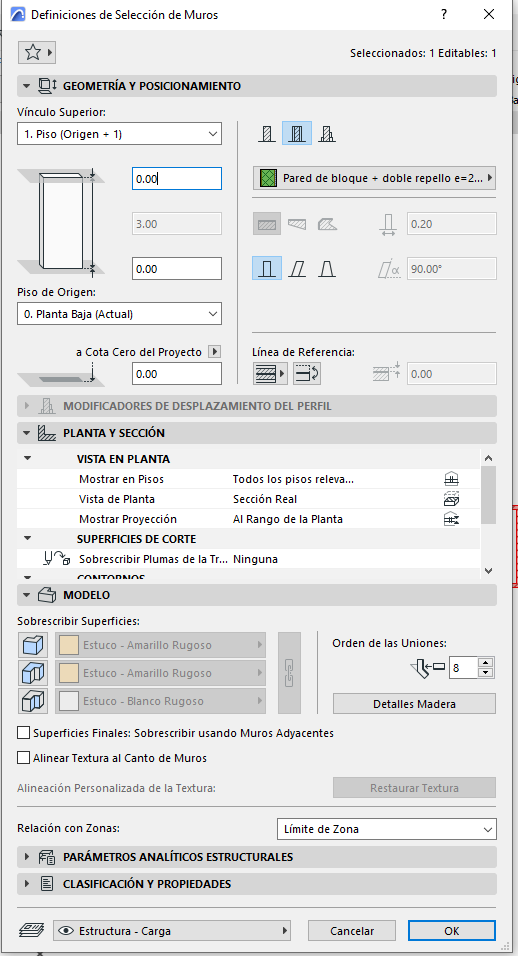

I'm creating a new template from scratch and new composites. When creating it, I made sure to mark that it could be used as a composite for walls.
However, when drawing the wall, I cannot see my newly created composite; it's just red.
I attach the images. Any idea what's wrong?

Check your Renovation Filter? For some reason Renovation Status can be set when the filter is turned off...
Solution
Set a renovation filter that does not override anything.

Thank youu!! In some way, I fixed it with your answer. If i put the wall in existing it apears de composite, but if i put in demolition or new it changes again. How can I make the composites look in the other renovation status?
I really thank you for your help.
Solution

Thanks to you both! I solved my problem.
