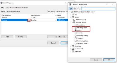

4. Map your zones
It is crucial to define your Load Categories and their settings to easily adapt Automatic Live Load Generation in your workflow.
After defining or checking Load Categories, open Options > Load Mapping..., select your chosen Classification System, then start mapping Load Categories to Zone Classifications.

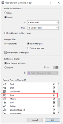

5. Adjust your workspace
One last step before generating live loads is to make sure you switched to Structural Analytical Model view and your zones are visible and editable in the current view. Make sure their layers are set to be visible and unlocked, and in case of a 3D window, in Filter and Cut Elements in 3D under Element Types to Show in 3D, the Zone option is also checked.

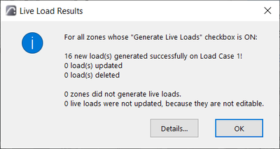

6. Generate live loads
Now that your model is ready, you can generate using the Design > Structural Analytical Elements > Generate/Update Live Loads command.
Once Archicad has finished the live load generation, you can review the results:

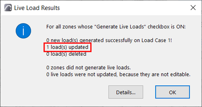

7. Update live loads
It is possible to update live loads the same way using the Design > Structural Analytical Elements > Generate/Update Live Loads command.
New live loads are created, updated, or deleted as needed, to reflect changes in the model (e.g., zone geometry or classification).
