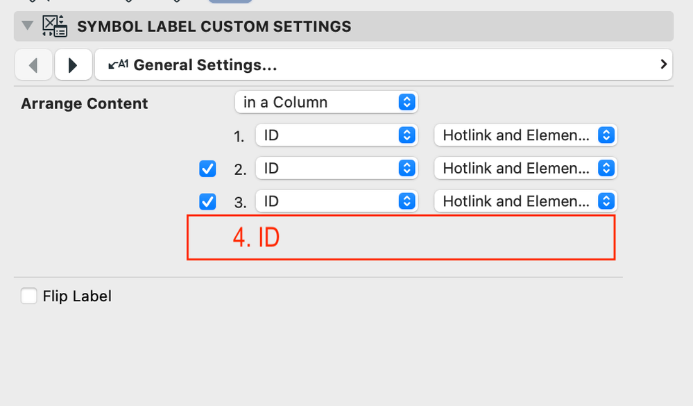

Can I add another content to the default Property label by Archicad?
I tried recreating the parameters when I "open object" but it doesn't reflect in the label settings. What step am I missing?
I've attached images of the parameters I added and where I want the additional content to be reflected.
Solved! Go to Solution.
2023-04-03 11:04 AM
You have to code it in the interface script.

2023-04-05 06:46 AM
Thank you.
Took a couple of more steps but it worked!
