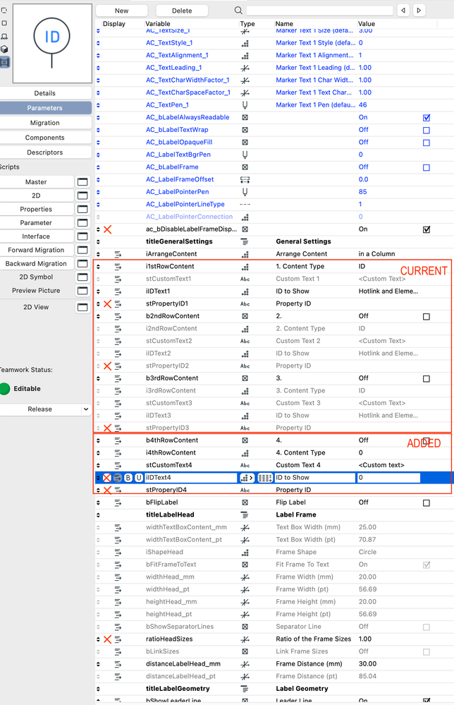

Can I add another content to the default Property label by Archicad?
I tried recreating the parameters when I "open object" but it doesn't reflect in the label settings. What step am I missing?
I've attached images of the parameters I added and where I want the additional content to be reflected.
Screenshot 2023-04-03 at 12.45.34 PM.pngScreenshot 2023-04-03 at 12.45.42 PM.png

You have to code it in the interface script.

Thank you.
Took a couple of more steps but it worked!

Is the interface script editing as simple as the part above? I.e. just copy/paste and duplicate some part of the interface script and change "3" to "4" in some places? I'm not competent at coding, but would like to have a more flexible label.
Optimally I'd like to have the option to have a simple reference line like that label has for standard Text/Autotext label, but a suboptimal workaround could be to make 4-5 content lines. Being able to make a editable prefix and suffix to the content would also be good.
I also see a weird bug where "Content 2" is not in line with "Content 1 and 3" if I set them all to the same text, as if "Content 1 and 3" is centered and "Content 2" is adjusted to the left. I attached a screen shot showing this.
