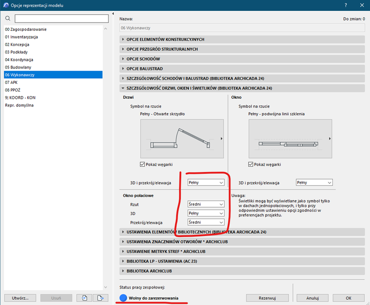

Hi all,
I've found multiple threads regarding that issue, but this seems to be the most recent one. I'm replying here with my potential discovery about the cause of that problem - I hope it may lead someone smarter than me (especially from GS) to a solution.
The issue of Missing MVO happens for me only in Teamwork projects (I'm working currently on AC 24 build 7006 POL FULL) and I think I've found out why it happens.
Whenever a user wants to overwrite temporarily Layer State or Pen settings for a view, AC allows him to do that by creating User defined settings for those. That's not how MVO works though (and that seems to be major cause for the problem) - it MODIFIES the MVO WITHOUT creating temporary setting. It shouldn't be allowed in TW projects BUT IT IS. There is a problem that when you open MVO in a TW project there are few settings (seems random) that you are allowed to modify even without reserving MOV settings. Given the fact that MVO works differently from Layers and Pens you end up with settings modified by user that didn't reserve them. It seems to me that this might be the main cause of the problem.
On top of that when you open MVO without reserving and you switch back and forth between MVOs all the settings become locked - so there seems to be a script that controls the ability to edit them for reserved state, but it doesn't seem to run when you open MVO at first.
Here is an example of a MVO window opened without reserving (I can modify couple of settings and still click OK - thus causing a conflict IMO):
And here is a state when I switch back and forth between MVOs (all settings are now locked - which is good - how it is supposed to be):
If this issue has been resolved in more recent versions of AC then great, but maybe it could be an easy fix even for older versions (with just a simple hotfix).
