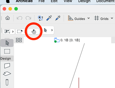

In Archicad 28 version 3060, the function to temporarily toggle Quick Select with the spacebar is not working, while using Shift + Spacebar does work. Is there a way to adjust the settings to fix this?
PS 1.
I've already tried resetting the settings.
PS 2.
Rolling back to version 3000 restored normal functionality.
Operating system used: Mac Apple Silicon 15.1(24B83)

1 ACCEPTED SOLUTION
Solution
Hello there,
I updated the Insights post about the Archicad 28.0.1 Hotfix release where this issue is addressed in detail.
UPDATED: Archicad 28.0.1 Hotfix release - Graphisoft Community
But to reflect on your questions directly:
- the easiest way to revert to the previous version is to perform a "Repair & Install" of the main release version of Archicad 28 (build 3001).
- we are currently working on fixing this defect, and intend to include the bugfix in the upcoming AC28.0.2 Hotfix, which is expected to be available in a couple of weeks.
Apologies for the inconvenience and thank you for your understanding!
Kornél
Beleznai Kornél
Technical Support Engineer

I'm having the same problem and got some messages from other colleagues.
When I open shortcuts in web browser, there is still spacebar for magic wand and magnet but.
I've found out that when trying to turn on/off magnet, you can press shift+spacebar.
For magic wand to work, you need to press shift+spacebar and then release the shift.
