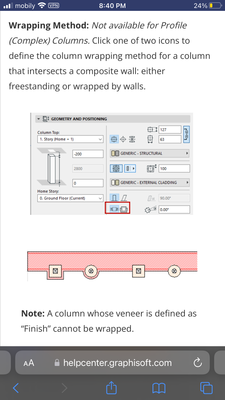

Hello, I have question for you.
There is intersection problem between my composite wall and column. As you see reference lines are ok but in 2d lines are not intersecting and in 3d there is no plaster on my column rather it shows my insulation which is in outside.
Thanks for your help...

I see the problem in 2D is coming from an element at the extension of the wall at the red arrow so try to reset its reference line.
In 3D there's an option for the column lets composite layers wrap around the column you can activate from the column selection settinungs.
