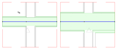

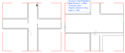

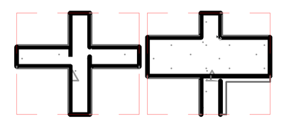

Is there a technique when 4 walls meet at one point?
The left side is the same type of wall
The right side is an L shape with two identical walls.
Left 4 wall  and right 2 wall
right 2 wall
this is my best
AC27 on window 11

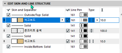

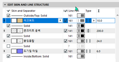

Ernest Atanasiu
If Building Materials have the Intersection Priority correcly set-up, that intersection should be cleaned automatically.
In most cases it helps to move the Reference Line next to one of the Core lines and keep that rule consistent.
