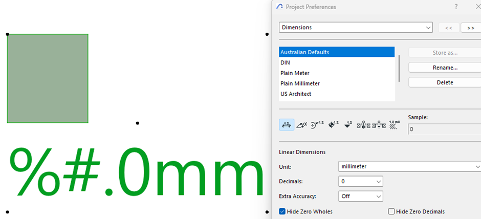

It is possible to code to detect the units being used for dimensions set in Project Preferences
n = REQUEST("LINEAR_DIMENSION", "", format_string)
if you the add this to a simple object, then add;
text 0,0, format_string

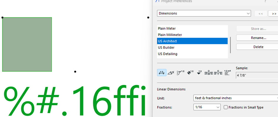

then a basic object can detect the format of dimensions i.e.
or for metric
using this principle you can get the object to select the correct style of Scale Bar
if STRSTR(format_string,”f”) > 0 then
!!! draw “Imperial Scale Bar”
endif
if STRSTR(format_string,”m”) > 0 then
!!!draw “Metric Scale Bar”
Endif
The Key problem is with the new libraries in Archicad 28/29 you will find Metric elements like the "Scale Bar" creeping in and replacing Imperial versions from the US library.
Graphisoft needs an option for a universal Scale Bar object to combine these with a setting like,
Unit;
Automatic
meter
decimeter
centimeter
millimeter
feet & fractional inches
feet & decimal inches
fractional inches
decimal inches
to match the dropdowns in the dimension settings;
