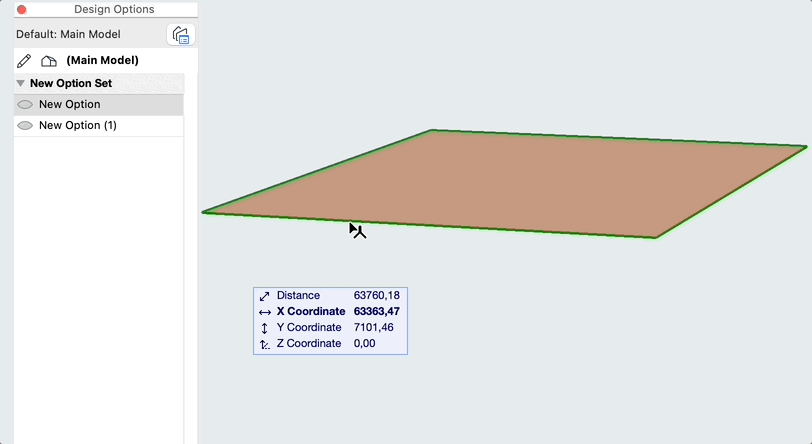

If your mesh is the main model and your translucent slabs and roof elements are the design options then SEO will work like you want them to work.
With the design options hidden, the mesh will be fully visible.
When you show the different options, the mesh will contains holes created by the SEO (in this case i used substraction with upwards extrusion).
The SEO operation will not be copied when you make a copy of the design option (you will have to do 40 SEO options but only on one mesh)

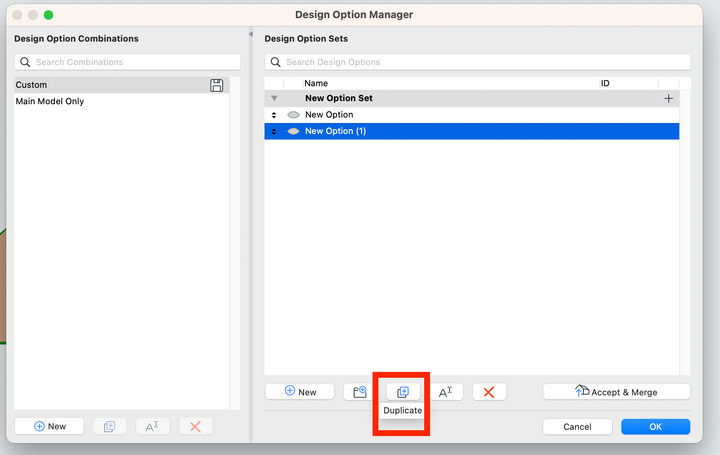

Yes - design options will help with separating the intersections but it's unfortunate that we still have to manually multiply elements for different positions/dimensions.
Maybe I am misunderstandig but if you selection an option and click on duplicate, the whole option is duplicated, you don't have to multiply.
