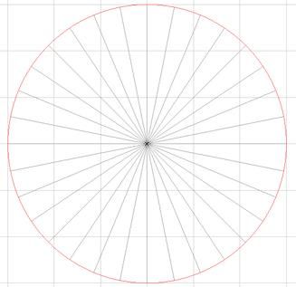

There are two ways to create a spiral stair using the new Stair Tool: using the Magic Wand using the 'Arc by Centerpoint' command from the Pet Palette during the input Using the Magic Wand Place a circle on the floor plan ( Guide Line Segment,Line Tool, Wall Tool can be used...
